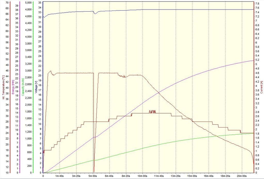

The following graph is of an 8 cell 5Ah LiPo pack being recharged after using just over 1 Ah capacity:
I should also point out that I do not have a BMS on any of my LiPo packs, but I do keep a close eye on the balance of the individual cells and will occasionally carry out a balance charge, which takes a lot longer than the standard charge shown above.
The charging current at the beginning of the charged peaked at 4.7 Amps and then continues to charge at high current (which is limited by the 150 watt charger output) until the target voltage of 33.6V is reached at around the 10 minute mark.
The charging then continues at this constant voltage and the current gradually diminishes as less current is required to maintain the pre-determined battery voltage.
The charging process ends after 21 minutes and 10 seconds, and during more than half of this time it was charging at less current than the charger is capable of providing.

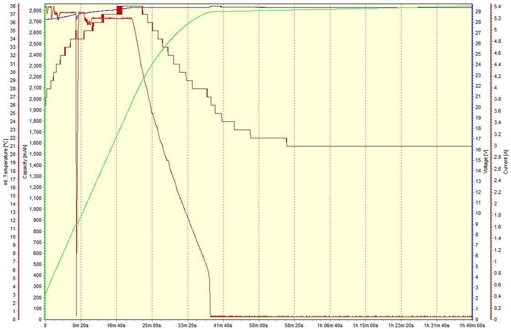

Here is a graph showing a balance charge on a 7 cell 10Ah LiPo pack as a comparison:
The first few minutes of this charge are missing from the graph as the monitor software was not running when the charging was started, but it clearly shows how much longer the fine balancing of the cells can take at the end of the normal charge.
I don't think that 6 hours is too long for a 10Ah battery being charged at just 2 Amps while all the cells are also being properly balanced each time, so I would say that your charger, battery and BMS are probably fine.
