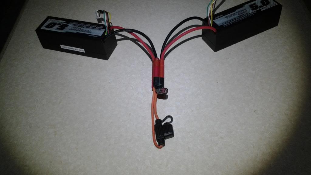

Sounds like the 8S lipo is the way to go.  Do you have a suggested source for 8S Lipos?
I use two of these cheap and powerful Turnigy 5000mAh 4S1P Hardcase packs from Hobbyking.com connected in series:

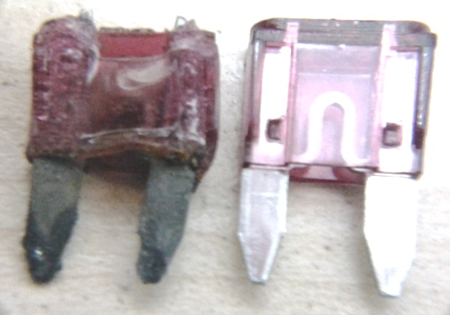

I use a standard 40 Amp fuse with the Smart Pie:
But I made a special 80 Amp fuse for my modified Magic Pie as the fuse holder just couldn't cope with the high current:
« Last Edit: July 02, 2017, 11:09:20 PM by Bikemad »
