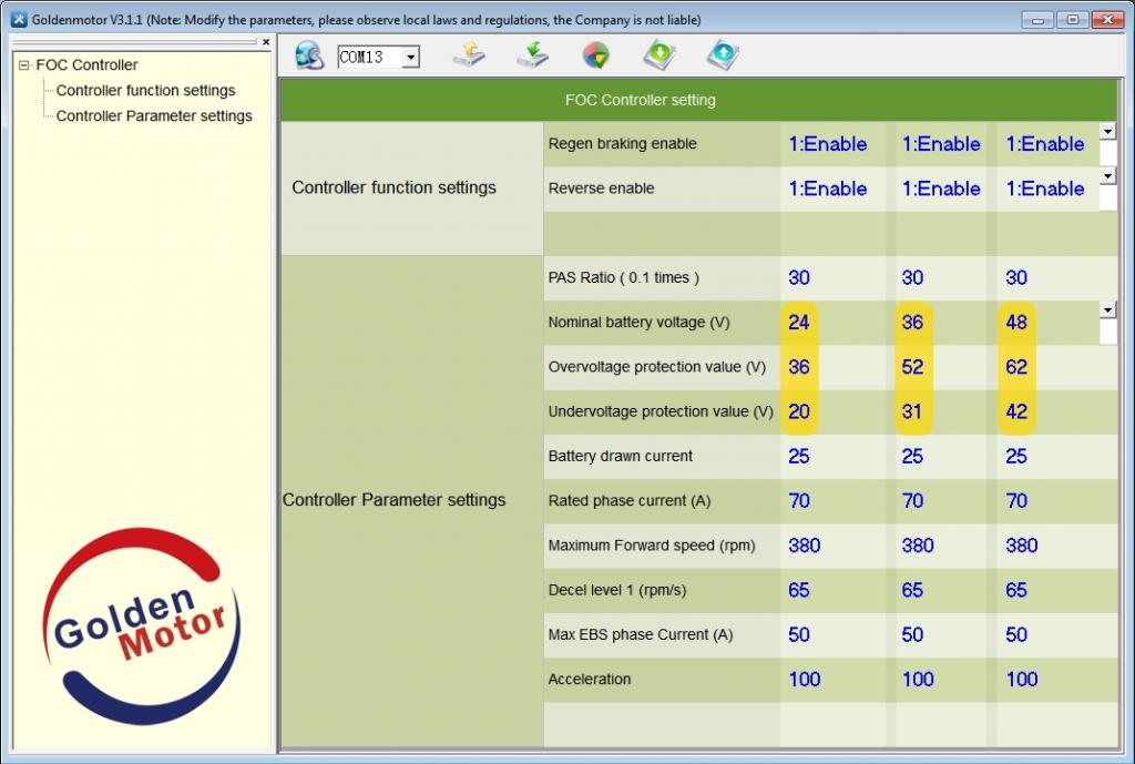

If you are using a 24V or 36V battery, it could simply be that the front controller has the battery voltage set to a higher voltage than the rear one and the actual battery voltage is too low to allow the controller to work. If this is the case, you will need to use the USB programming cable and software to adjust the voltage setting to the correct value.

If it is displaying error code "8", the controller voltage setting is probably too low for the 48V battery. I don't know whether this would cause the battery gauge on the Smart Display unit to show the very low reading, but if the controller voltage was set to 24V or 36V, the motor would not run on a 48V battery because the default Over Voltage Protection value would be much too low for a fully charged 48V battery:
Try plugging the BAC-601 into the rear motor connector and see if all the bars are displayed correctly. If all the bars are showing on the rear but not on the front (with 54 volts on the motor harness) the front controller will either need to be reprogrammed to the correct battery voltage, or if all the voltage values are already set correctly, the controller may need to be replaced. :(
Unfortunately, you will be unable to check the controller settings if you don't have the necessary USB interface cable, but if you have the USB cable you will need to download the Vector Programming Software, if you haven't already done so. ;)
