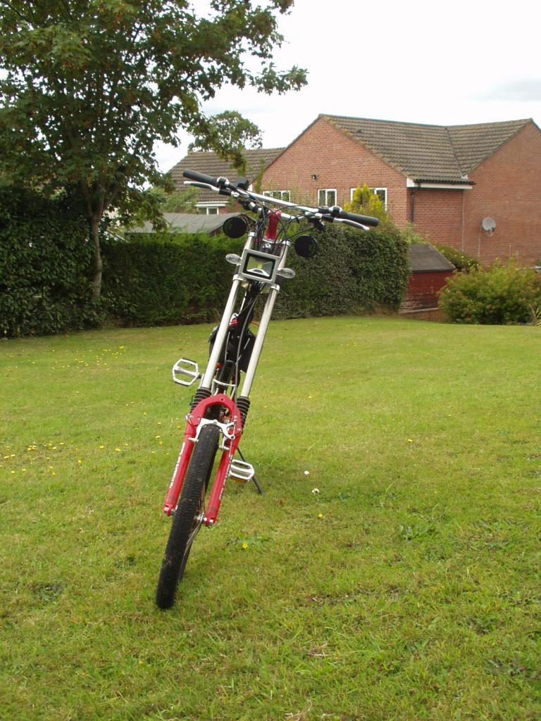

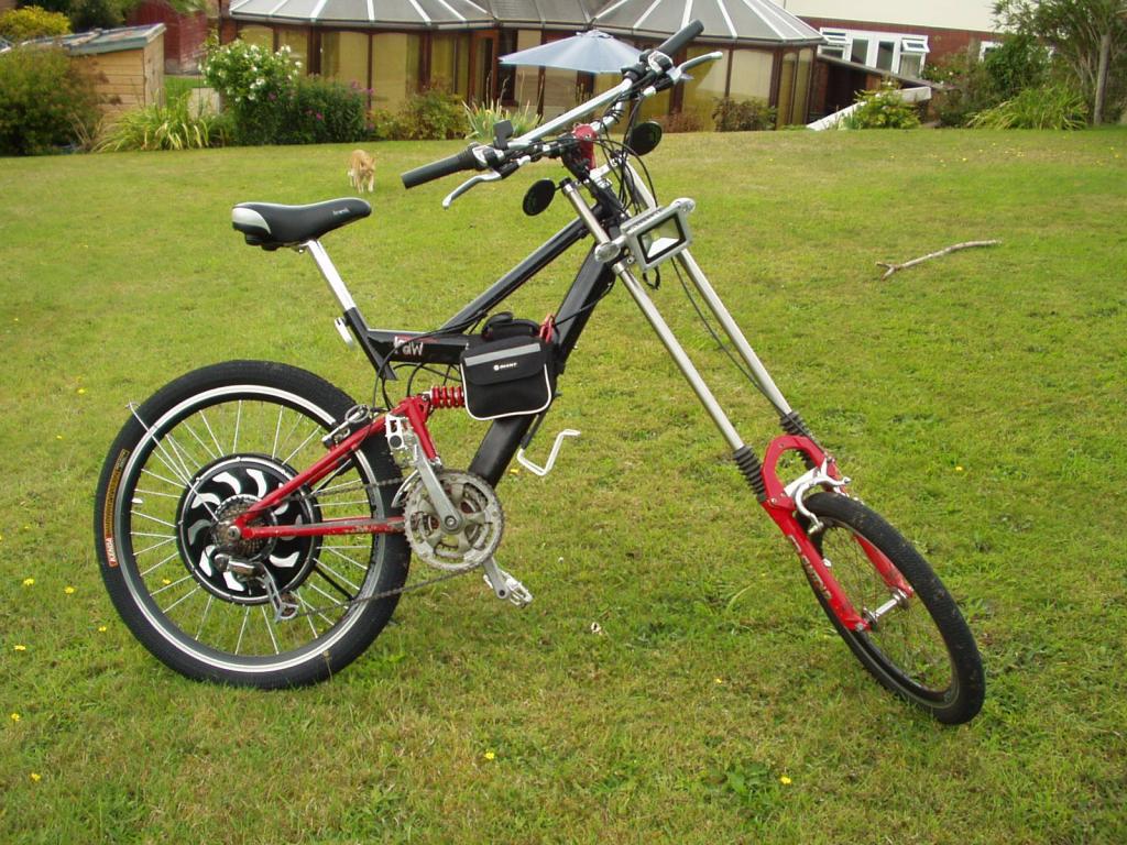

I am currently using an MP4 kit on my home-made chopper bike (A.K.A. the wheelie machine):
The MP4 is a very good motor and the new vector controller makes it incredibly quiet to use.
The motor is not 100% silent, but it isn't any noisier than riding with the battery turned off!
The MPIII becomes quite noisy under heavy load due to the "pinging" noise produced by the stator. The vector controller does not cause the pinging noise so the motor makes the same noise relative to wheel speed on full throttle as it does with the throttle released. If you pedal enough to prevent the freewheel from clicking, the total lack of additional motor noise when the throttle is applied is quite impressive.
The torque on the MP4 is very impressive too, so much so that I had to reduce the acceleration setting to allow the front wheel to remain in contact with the ground every time I pull away from a standstill (especially on an up-hill incline). On my front mounted Smart Pie 4, I also had to reduce the acceleration setting, but that was to stop the front wheel from spinning while pulling away on loose gravel and wet road surfaces. ;)

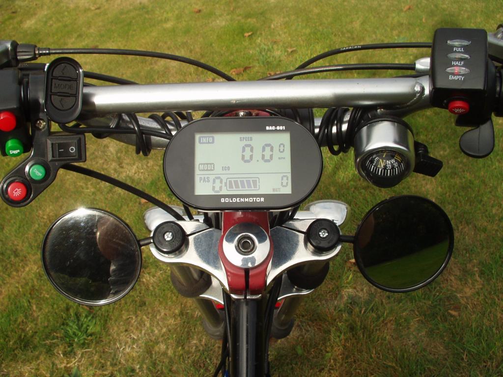

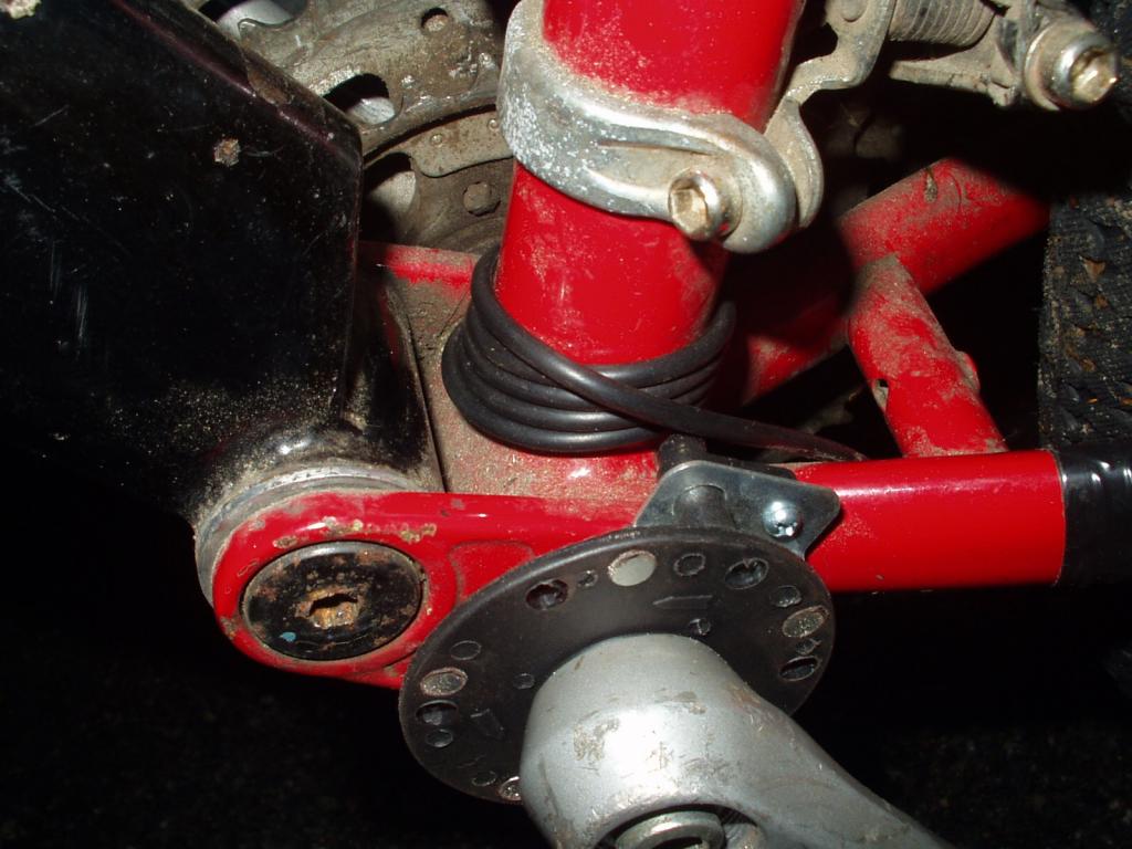

I also have the BAC-601 Smart Display and pedelec sensor unit fitted to the wheelie machine and they both seem to work extremely well with the MP4:
The pedal assistance is automatically turned off when level "0" is selected, but when needed, you can select an assistance level of anywhere between 1 and 5 by simply pressing the up or down buttons. Although with my current power settings as high as they are, the wheelie machine can be quite dangerous to use at slow speed on setting 3 and above. If I start to pedal a little bit too hard, the front wheel lifts up very quickly. Although I instinctively stop pedalling immediately, the slight delay in the pedelec power cut off means that the wheel just keeps on lifting, and if I don't grab the brake levers quick enough it will actually flip me over backwards. But to be fair, this would not happen on a more conventional bike:

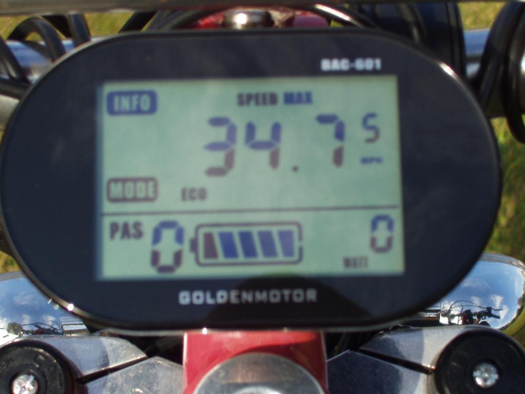

I tried lifting the rear wheel off the ground and gave it full throttle, and I was surprised to find out exactly how high the unloaded speed of the motor is on a 48V battery pack:
So, if you were hurtling down a steep hill at full throttle, it would just be the wind resistance holding you back, as the motor itself would not produce any drag until you began to exceed 35mph.  ::)
The only negative experience I had with the MP4 was trying to figure out how to program the controller, but having discovered the correct procedure for connecting to the software it is now very straightforward.

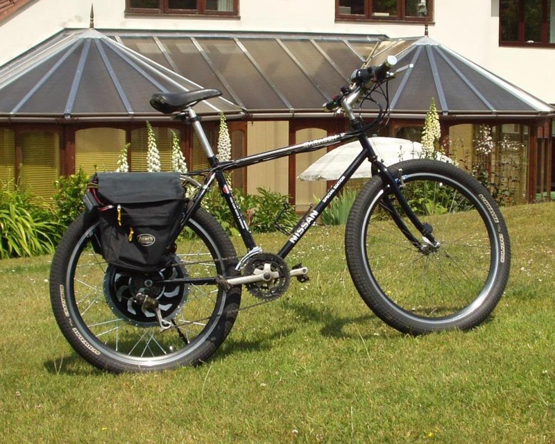

I have six GM motors, and apart from the offset rim and badly fitted spokes on the first Magic Pie, and blowing up a couple of modified internal controllers, I can honestly say that I am very happy with all the GM products that I have used, and especially the MP4.

Bikermad. What kind of Light are you having on the wheelie machine
And the extra Light and horn switches is that GM standard or where can I get one of them?
Re: Anyone have any experience with the new Magic Pie 4?
« Reply #12 on: January 18, 2015, 10:56:51 PM »
The "Wheelie Machine" is basically a work in progress fun bike which is currently being used for testing the pedelec function of the MP4 controlled by the BAC-601 Smart Display unit.
The front light in the above photo is a 240V 10W led floodlight, although it seems to run very well off a 48V battery.
Unfortunately, the very widespread light means it can only be used as a main beam or headlamp flash for road use as it would be extremely hazardous to oncoming traffic in the dark. ;)
I plan on installing a DC-DC converter to provide a 12V supply directly to the LED from an eight cell 29.6V LiPo battery pack which I mainly use more often than the bigger 48V pack.
The additional switch is available from Gary (GM Canada):
But I will be replacing the existing on/off rocker switch for a three position rocker switch to operate the indicators:
