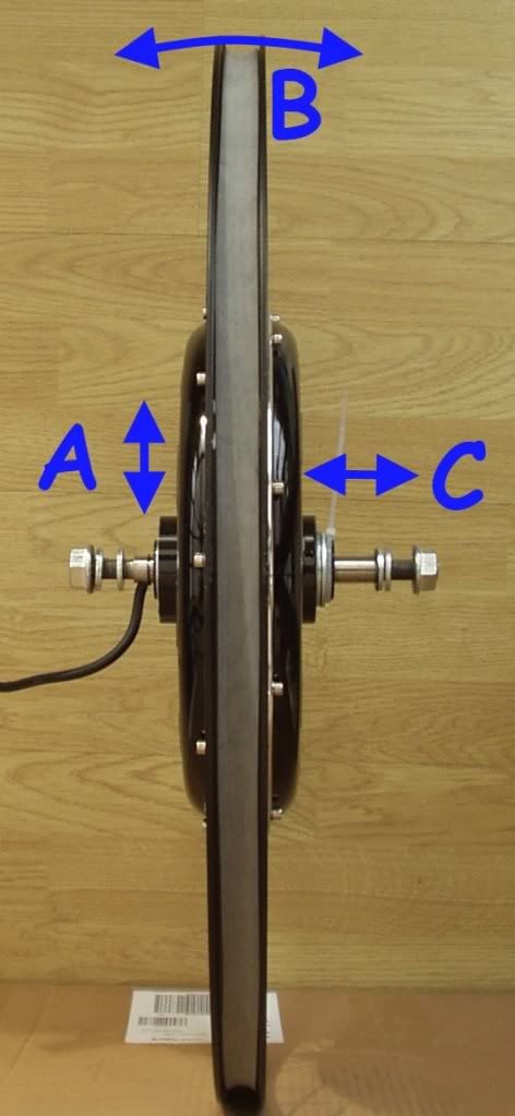

Those are spacer shims, which are fitted on the axle before the cover goes on.
They are needed to remove excessive end play between the bearing and the stator, therefore preventing the hub assembly from moving sideways on the axle as indicated by C  below:

I had placed them on the shoulder of the shaft, but when I put the faceplate back on the faceplate wobbled until I snugged up the socket head bolts around the perimeter...
Without the washers the faceplate laid flush...I just never checked for play in the "C" direction.

It would appear that GM have taken notice of one of my previous my posts regarding bearing play and are now using solid shims instead of the wavy washers to preload the bearings, which should considerably reduce the movement indicated by B.
