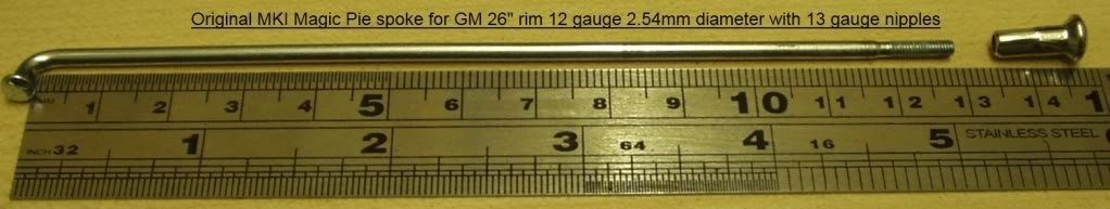

I have been looking for ages.
can any body tell me where I can buy some new spokes in the UK for my mp2 26" wheel I believe they are 12/13gauge 110mm long.
I know Gary sells them but don't really want to ship them all the way from Canada.
Has any one found a UK source?
Many thanks in advance.
