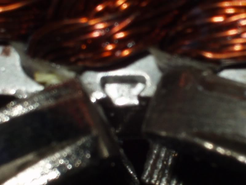

The hall sensors on my Magic Pie were stuck in so tightly I had to break them out in little pieces using toffee hammer and a small jewellers' screwdriver as a chisel, and discovered there was a fair amount to chisel out before the new sensor fitted easily into the slot.
I used a couple of pairs of mole grips to try and prevent the stator laminations from separating while I gently chiselled away at the remains of the old hall sensor:

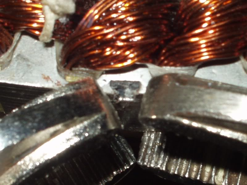

All the broken broken bits were removed:

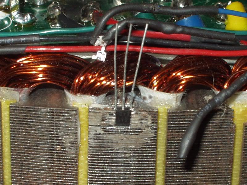

So the new sensor could slip nicely into the slot:
I did have a few gaps between some of the laminations (one is just visible in the above photo), but when I applied the superglue to hold the new sensors in place, I put some in the gaps and kept the laminations tightly clamped while the glue dried to eliminate the gaps!
