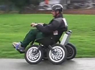

I'm thinking of lashing 4 x 16" cast wheels to of these as a base
The four 16" cast wheels I can understand, but a vacuum flask seems like a very unusual choice for a vehicle chassis:
something like this would make more sense:
          Click to watch video on YouTube.
Are you sure that was the correct link?

If y'all are interested, I threw together a little video of my trike.
I'm still getting a reading of "empty" on my throttle, but I'm getting a full 40V out of the 36V battery.  After a 14 mile ride (with a bit of peddling) the charge still read 38V so, that's good.  If I measure the charge going to the throttle, what should it read?
Goldenmotor China still hasn't responded to my emails though.  I'll post a report about my ordeals with them later...
meanwhile:
http://vimeo.com/24362622
As always thanks to all your help.
Bart
