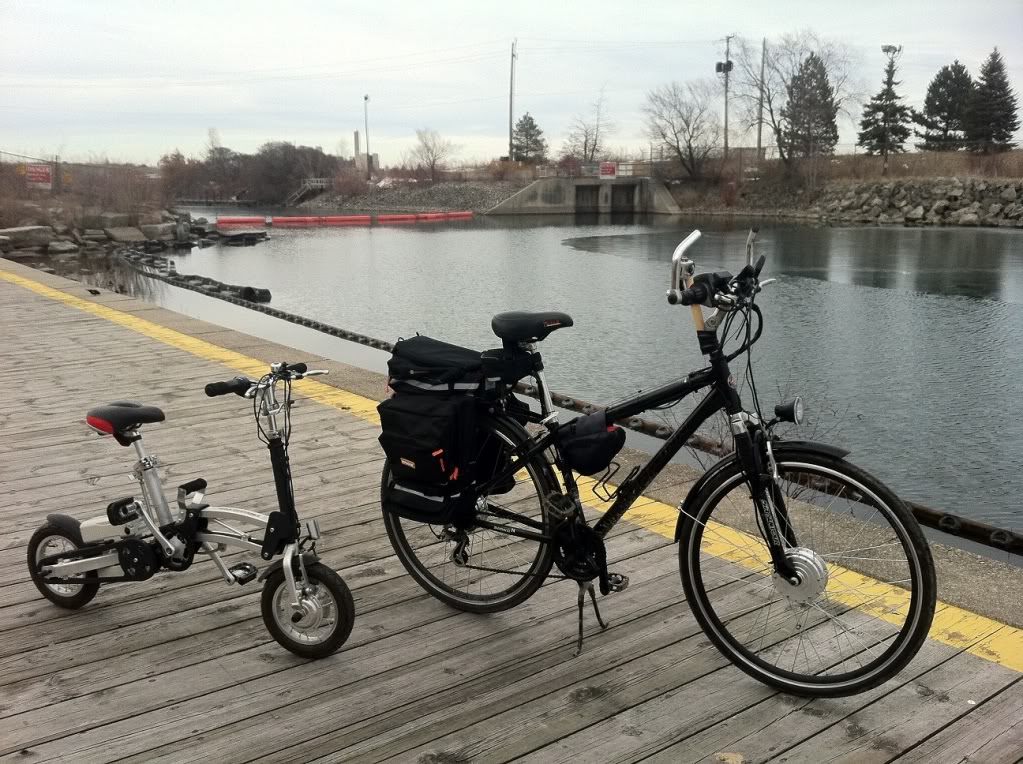

PS Also had a ride to the lake with my son today..
