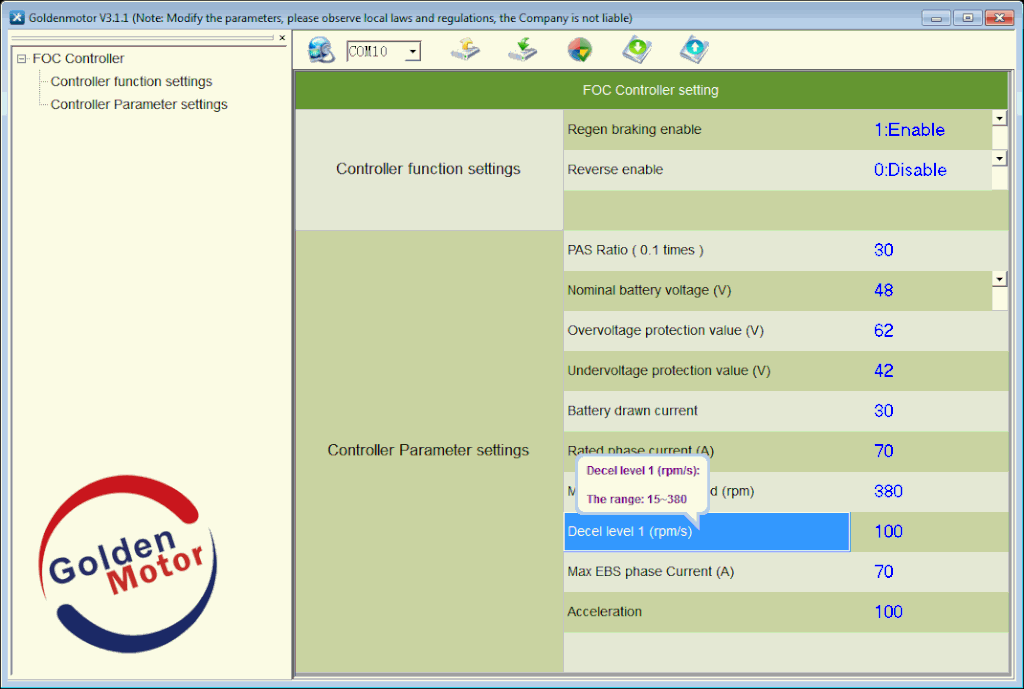

** Is there any other way using application / software to change a parameter without having to disconnect the cables and stopping the bike will be a gradual rather than a suddenly?

You should be able to either reduce or completely disable the Regenerative braking setting within the software using the USB programming lead to reduce the sudden jolts on the axle.

You will need to reduce the Max EBS Phase Current (A) (or EBS PEak Phase Current (A)) to reduce the regen forces acting upon the axle, or disable the regenerative braking altogether using the Regen braking enable (or EBS Enable) parameter:
The parameters are named differently with different versions of the software.
