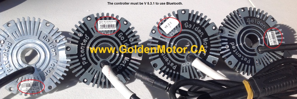

« Reply #5 on: December 11, 2015, 03:20:10 AM »
Hi Gary,
i have two MP5 controller, 1 for 26" MTB & 1 for 20" Foldie.
this one (refer picture) for 26" MTB can detect the bluetooth dongle inside the app but still cant connect.. & the motor can run normally
the other controller 20" Foldie cant even detect the bluetooth dongle.. there is blue light blink for few second.. there is battery light indicator at throttle but the Motor is dead! can not run at all..
best regards,
MrBulp
Re: MP5 Controller Death?
« Reply #6 on: December 14, 2015, 10:34:49 AM »
Are you able to connect to either controller using the USB lead and PC software instead of Bluetooth and Android?
Have you tried plugging in the other Bluetooth dongle to see if the motor runs with a different dongle?
It might help to determine whether the controller or the dongle is causing the dead motor problem.
