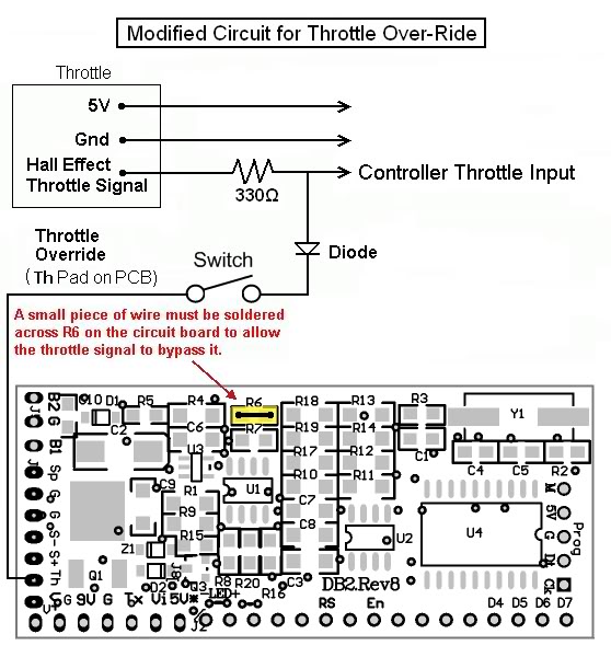

The throttle override function on the Cycle Analyst only allows it to reduce the available throttle to restrict the current, it cannot therefore produce additional power.
The early Cycle Analyst required a 330 ohm resistor to be fitte into the throttle signal wire as well as shorting out resistor R6 inside the Cycle Analyst:
The switch is optional, but it enables the Cycle Analyst throttle override to be connected or disconnected to quickly swap between restricted speed/power and unrestricted speed/power.
I don't know if this is the same for Version 3, but Gary (GM Canada) should be able to confirm what is needed.
The original solution to the Cycle Analyst problem can be seen here.
