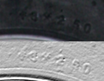

I was trying to see what tyre GM had fitted on the original 16" Pie:
After some close inspection it appears to be a 13 x 2.50 tyre:
But I can't find this size tyre anywhere on the web. ???
If you measure the inside diameter of your current tyre it should confirm the correct diameter (12.5" or 13")
