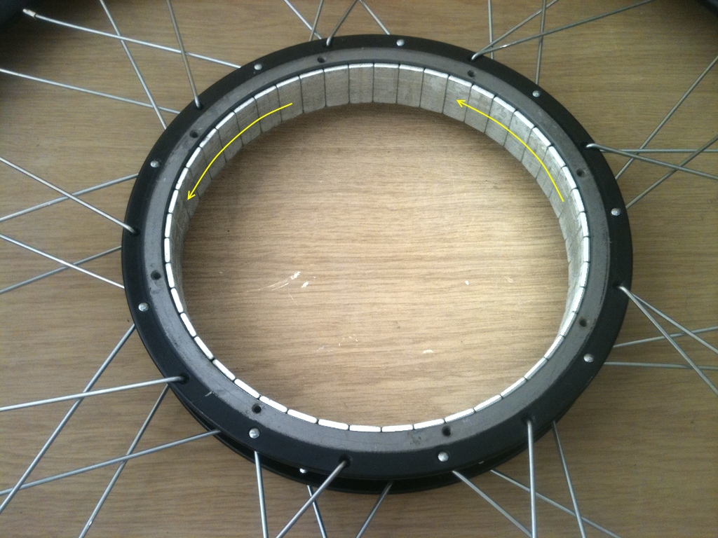

I looked carefully on both magnets area of motor ring & stator and nothing was poping to my eyes...
Magnets on motor ring are a bit covered by a white substance but it all magnet are same. I didn't found one point which looks different from the rest. Neither on the stator side...
Any ideas to help me?

After studying your pictures, I would say that the magnets and stator have definitely been rubbing together.
The front area of the stator in the picture below shows signs of abrasion from contact with the magnets:
And many of the magnets appear to have have surface scratches running in a radial direction around the magnet ring which would also indicate physical contact with the stator:
It looks to me as if the binding is only very slight, so it should only require a gentle bit of sanding on the outer surface of the stator with some 80 grit sandpaper to remove any suspected high spots, and then blow out or vacuum any dust before applying a protective coating of grease or petroleum jelly etc.
While it is apart, I would also lightly clean around the inside of the magnets with some 600 grit wet & dry (used dry) just to remove any surface deposits which may have built up, and then clean thoroughly with a cloth before colouring the surface of the magnets with a permanent marker pen so that any further contact points would be much easier to pinpoint if the motor was still found to be binding slightly after reassembly. ;)

In fact, the marks you highlighted on the stator are present all around the stator. I'm not sure they appear because of the specific rubbing point because the blocking area is very localised. I wonder if I didn't make those marks during my different attempts when dismounting the stator.
Anyway, I'll do some sanding on the stator side (I fear to sand magnets and damage them and/or remove the surface treatment against corrosion that may exist on them (Nickel plating?))
It's a good idea to put some permanent marker in order to facilitate futur investiguation :)
