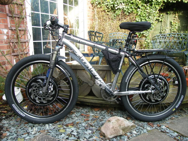

Dual pie,   Is was a bit of a bad boy!
Nice fat tyres..

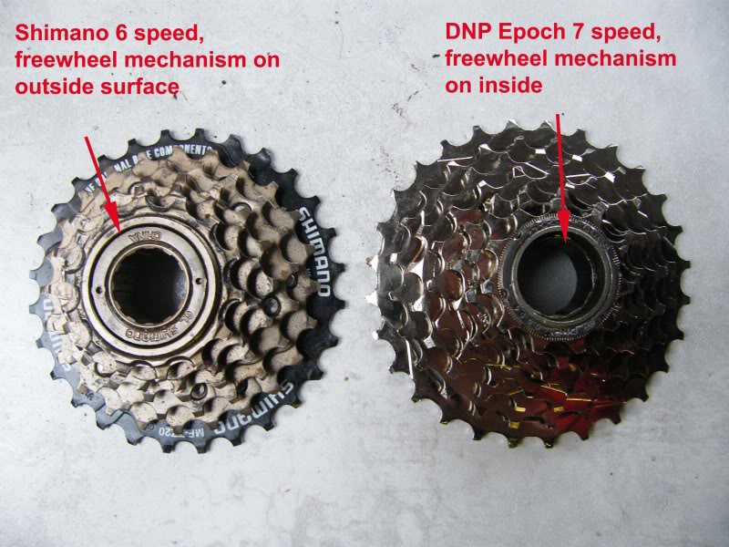

Dnp 11T freewheel and 48T chain wheel needed.
Dual mini motors.  A nice 'civilised' ride. I was lucky enough to get a bespoke battery pack made by a friend and forum member Dirtyginge, aka Paul. I was never happy with a rear mounted pack.
Don't ask me how I wired it, but I did!
My wifes front wheel mini motor build..

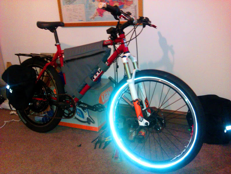

The 'tron' bike.  I used a steel frame with horizontal dropouts.  I highly recommend these frames for a hard tail mtb build.  Bendable steel for squeezing in rear axles and slot dropouts for piece of mind.

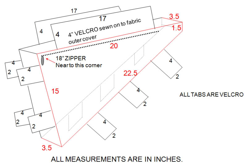

Bespoke made to measure frame bags to maximise battery capacity. I have had a 84v 10ah li-ion pack in this bag along with a contoller.
This hardtailed steel frame has been a favourite of mine for recent off roading...

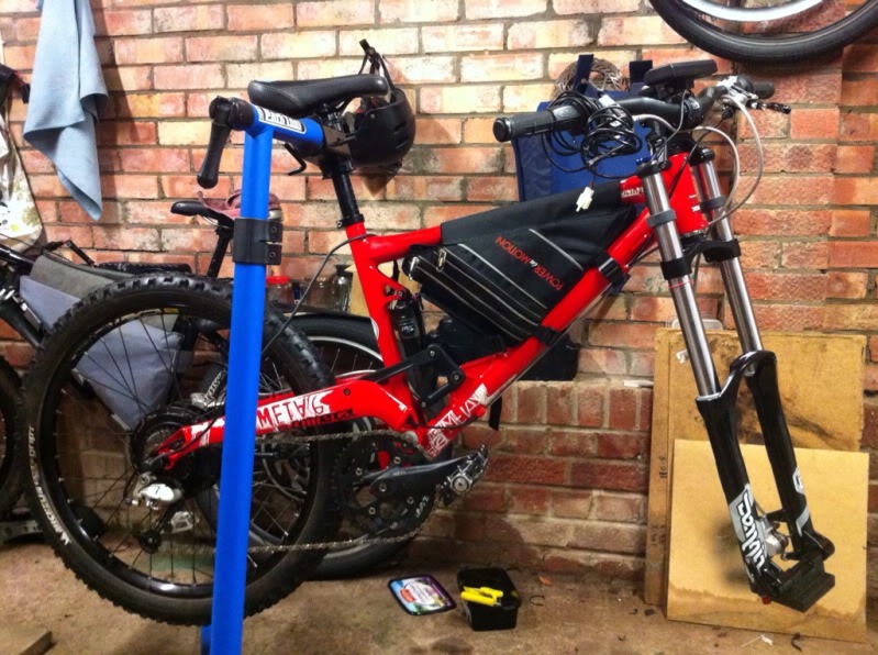

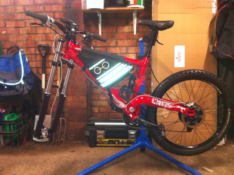

Anyway,  here are some photos of the new full suspension downhill bike.
« Last Edit: December 28, 2012, 10:33:41 AM by Andrew »
Re: Downhill MTB build. "The Beast" (lots n lots of photos)
« Reply #2 on: December 28, 2012, 10:31:52 AM »
Commencal meta 6 frame
Rockshox domain dual crown fork.
Beginning the build
The frame comes with 12mm through axle dropouts, shame that a motor axle will just spin freely with these. I am sure you can get 10 mm ones which could be filed out to a 12 or 14 mm curve for a hub motor.
I went for vertical dropouts which are quite deep, though realistically I will ned a torque arm. I had to do a little filing for a tight fit.
A rear motor in place, it is not a GM motor(please forgive me)' but it was a good bang for the buck solution for now.
I can foresee problems with chain slap
This is where I left things yesterday evening....
Lots still to do.

« Reply #4 on: December 28, 2012, 01:34:54 PM »
Hi,  the motor is a Bafang BPM 500w 48v geared free wheeling motor.
They are relatively inexpensive to purchase and get delivered from China to the UK so I thought I would give it a go. How long it will last off-roading is anyones guess. I should really have a direct drive motor for this purpose which off course has no moving parts.  I would like to try a mini pie IF they did them without built in controllers. It would be good to see how much wattage you could put through them. 48v and 25to30amp would be worth a go.

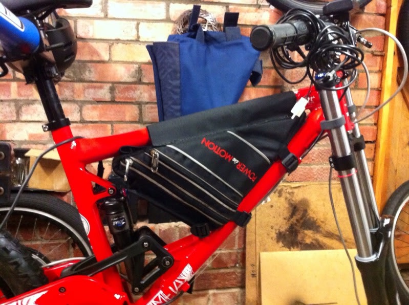

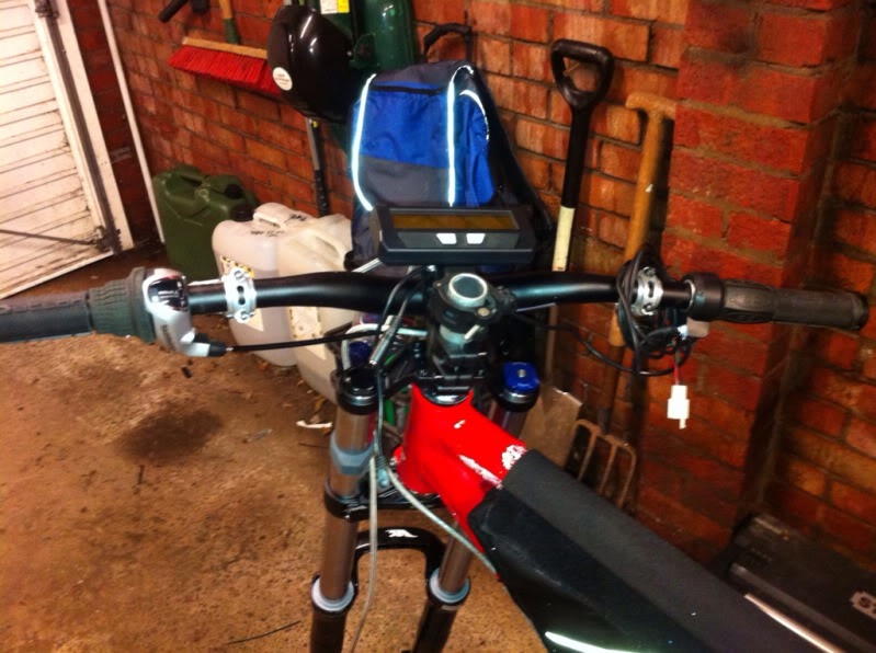

A few more pics from todays tinkering.
Had to add some velcro on the frame bag to hang it on the top bar. Glued and sewn on, it wrecked my hands sewing through the material and velcro.
I have left the neck of the forks uncut at present so I can fit the cycle analyst in a central position. I have just a half twist throttle and a rear gear changer on the handle bars.
I may get it up and running tomorrow :)
