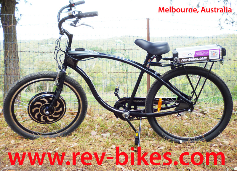

Hi Guys,
Wondering if any bright sparks have suggestions for mounting the brick shaped battery within the triangle of the frame, using some sort of U-bracket?  Love to see pics if anyone has done this, and where we can get the brackets from.
Thanks,
RevBec

Rebecca's bike has a much curvier downtube than yours, but it might be possible to mount it on the seat tube instead:
But I think the battery might be too big to actually fit in there.
