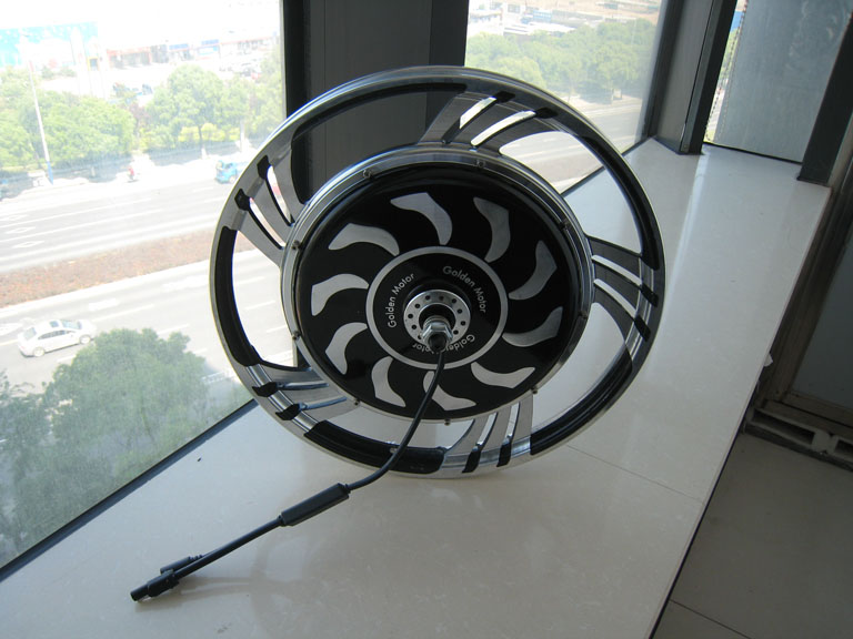

You may want to hold out for the MP2 as the wheel is centred strong good for an aluminium frame.
MP2= very soon
20" MagicPie is under production now and will be available by end of May 2010. You need a special USB interface cable from us to program the controller. It supports reverse and other existing cruise controller functions.
The Magic Pie II.  20" cast rim.
Picture supplied by Yuan Yao (above)
Image and design modifications by Who42 in GM forums.
Yes Who42 was kind enough to offer support to all future customers and GM has taken some great suggestions on-board from all the good members here to make what GM is calling the best all round Ebike hub motor ever to be made..  The Magic Pie 2
