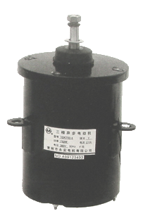

AC Motor
Price: $53.00--$105.00 Click to View Drawing
Models: YDK750 Series
Input Voltage: 380 VAC
Freq.: 50 Hz
Output Power: 250/300/550/750/950 W
Speed: 450/1400/700//910/1350 RPM
Current: 2.0-4.0 A
Noise: <50 dB(A)
Insulation: Class B
