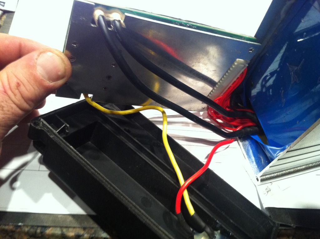

I would try and remove your BMS, I've done that with a pack I'm currently using and it is charging okay.
Just unplug the balance connector and desolder the big tabs, or if you want to leave it in there, just solder your discharge black wire to the Battery - tab which will bypass the BMS
Hopefully you can still get some use out of it :D
Here are some pics if that helps Good luck man!

So using this theory I should be able to clip the yellow and two blacks on this lifePO4 pack. Then unplud the bms and remove it. Then attach the yellow to the two blacks and the bypass is done. Correct?
Offline Cornelius
  • Posts: 241
  • Grimstad, Norway
Re: I fried my battery... don't do that.
« Reply #12 on: December 13, 2011, 11:34:13 AM »
Correct. :)
Do keep in mind that LiFePo4 are more robust when it comes to cell differences than the LiMnPO used in GM's (older?) packs, and therefore are usually ok without a bms, as long as the controller have LVD, and you doesn't overcharge. :)
