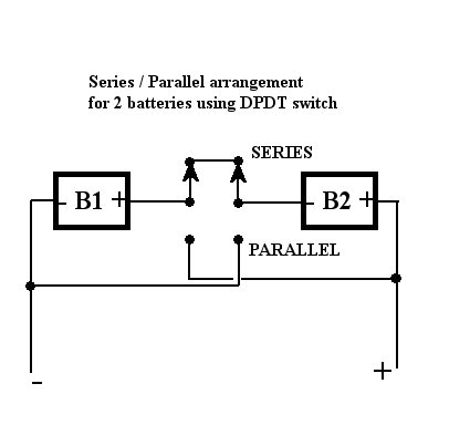

I'm impressed with the "double" battery - putting them in parallel to get double amps. How is this done and can you decide for each trip wether you want to bring one or both?
Can you also put two 24V in serial to get 48V and then still choose whether you want to bring one or both batteries on a trip - or would this be dumb?
Re: Series - Parallel battery switching
« Reply #54 on: May 21, 2010, 03:44:07 PM »
If both batteries are the same voltage and Ah rating, they can be connected in series or parallel and can be easily switched using a heavy duty double pole double throw switch as shown here:
When switched to parallel mode, either of the batteries could be removed if required.
Different Ah batteries can be used in parallel as long as they are the same type and voltage, but it is not such a good idea to run them in series, as the smaller capacity battery will run down much quicker.
Different voltage batteries of similar Ah ratings can be used in series, but not parallel.
I have found that regenerative braking produces more Amps, is much more aggressive and reduces your speed a lot more using 24V than it does with 48V, so simply switching voltages also allows two different levels of regen to be used.
(Unfortunately regen is not an option with minihubs)
Hopefully that answers your not so dumb question. ;)
