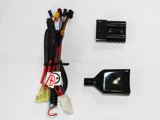

Hy i'm from france and new on the forum... i'm interested for a 24 volts motor controller and i need to now if is neccessary to buy the wires and connectors or it is in a pack with the controller ?  and a second question is it possible to program for ride in rear with the controller ?

« Reply #6 on: March 14, 2010, 12:53:20 PM »
Hi and welcome to the forum,
Someone will hopefully correct me if I'm wrong, but I don't think the leads are supplied when you purchase just the controller.
They are usually supplied when you purchase a complete wheel kit, but a replacement set is available separately in the accessories section of the GM website for $29:
